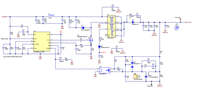

- Can Non-Isolated power IC like LM5165 be used for PSE power? Or should you use isolated power topology? When using a non-isolated power supply, it seems as if the voltages on the PSE board and the PD board will be connected as shown in the diagram below. Will this not be a problem?

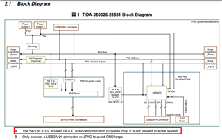

The supplementary comments for the block diagram of TIDA-050026-23881 say that "It (isolation) is not needed a real system," so I think it should be okay, but please let me know if there are any points to be careful about.

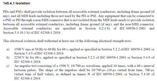

    Isolation is required for standard PSE input power.

    By the way, what does the comments for the block diagram of TIDA-050026-23881 "It (isolation) is not needed a real system," mean? If you believe this comment, it seems like the customer can use LM5165 for the power supply, which is contradictory.

    TIDA-050026-23881 used flyback for isolation.

    Could you let me know where you see the comments of " It (isolation) is not needed a real system,"?
    The comment is below the figure 1 of Block Diagram.

    I have checked the "145.4.1 Isolation" you advised, as well as the contents of the referenced IEC 60950-1 and IEC 62368-1.
    Based on that, I think that the requirement will be met not by isolating the power supply, but by taking measures to prevent the user from touching the GND of the power supply (LM5156 GND), for example by not connecting it to the product housing or the case of the RJ45 connector. What do you think?

  • Hi Taito,
    Your description may be correct but standard will always require isolation as its description.

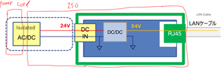

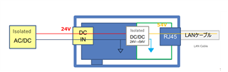

  • Hi Diang,
    Option 1: The LAN connector and the metal case are at the same potential. The LAN connector is isolated inside the board.
    [Question 1] Since the GND of the PoE power supply goes out of the product from the power connector, is it correct to understand that it is necessary to take measures to prevent users from touching it even within the blue dotted line?
    [Question 2] Would the configurations of options 2 and 3 be possible? Also, I would like to know the recommended configurations for options 1-3.
    Option 2: Insulate the power supply of the input part of the board.
    The GND of the input part, the case, and the LAN connector are at the same potential.
    Option 3: Insulate the power supply of the POE.
    Thank you for your help.

  • Hi Taito,
    Thanks for your patience.
    If I understand correctly your 24V output AC/DC already has an isolation as 145.4.1. If so, you do not need additional isolation, may need a boost the 24V to 54V using non-isolated converter, and an regulator to transfer either 54V or 24V to 3.3V. In this case, 3.3V, 24V, 54V shares the same ground that is isolated with the AC side ground.

  • HI Diang,
    Regarding Question 1 above, I understand that the answer is yes and that it is necessary to take measures to prevent users from touching the blue dotted line areas, but please let me know if I have misinterpreted the above.

  • Hi Taito,
    My understanding is AC is with the power cord that need human touch to connect, then after the AC/DC it is isolated.
    Diang
