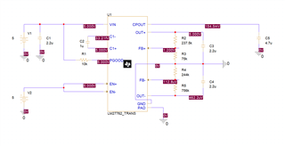

Hi, I'm asking because I've doing some simulations and I haven't been able to get the results I want, which is +/-5V.

Hello Farjan,
thanks for reaching out in E2E.
It is possible to achieve +/-5V with the LM27762. But the input voltage needs to be higher than 5V. (The device can only regulate down to a smaller +/- voltage, compared to VIN).
5.5V is the allowed maximum VIN.
Let me know if you have further questions.
