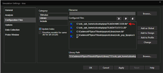

I've recently installed PSPICE-TI and am having an issue running a simulation with one of the parts form within the initial libraries provided (AMC3330-Q1). I have my library configured as:
I have the individual part in the config, as I had deleted (and was unable to re-add) the nom_pspti.lib as it wasn't in the same folder as the other included libraries. I found the individual part .lib file via its pointer within the property tab. Not sure if this requires a library update? Any help on what would be causing this to a file that the install came with would be a great help (this didn't work with the base config libraries included, that's why I deleted them in hopes to properly point to them).
I've provided the full error log below:
