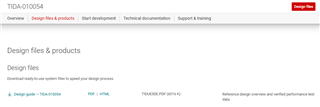

Please refer to the design guide chapter 2.3.4.1.
The design guide can be downloaded here: https://www.ti.com/tool/TIDA-010054#design-products
