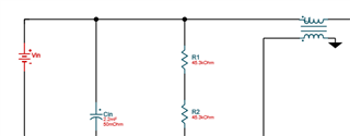

I have a question regarding the isolation transformer for the current sense line of the UCC28950.
Since the purpose of this isolation transformer is to provide isolation between the primary and secondary sides, is it acceptable for both the primary and secondary inductance values to be 20mH?
In WEBENCH, Lp is specified as 20mH.

  • Kyoshi,
    L1 in your design is to sense the input current. I am not sure what you are asking.
  • Hi Ning,
    I understand that L1 is for sensing the input current.
    My customer asked about the constant of the current sense L1.
    In WEBENCH, the Lp of L1 is 20mH, and in the EVM component, the Ls is 20mH. How should the constant be designed?
    Is it okay for both Lp and Ls to be 20mH?

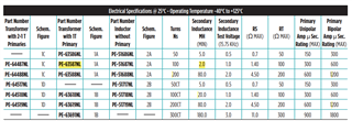

  • Can you share which EVM has a 20mH Ls?
    Do you mean this one in https://www.ti.com/tool/UCC27714EVM-551?
  • Hi Ning,
    Thank you for your reply.
    The PE-63587 on the UCC27714EVM-551 has an Ls of 20mH. Is it okay for both Lp and Ls to be 20mH?
    Kyohei
  • PE-63587 Ls is 2mH, not 20mH
  • Hi Ning,
    As shown in the attached diagram, Ls is 2.0mH. Is it correct to understand that the basic design with Lp:Ls = 20:2 is acceptable?
    Kyohei
    If the turns ratio is Nps = 1/100 the primary magnatizing inductance should be 200 nH.  Please see the math below.
    When it comes to current sense transformers the primary will always have less turns than the secondary.  You are trying to produce as little voltage drop as possible on the high current side.  So Lp and Ls should not be the same.  That would give a turns ratio of 1.
    Mike
