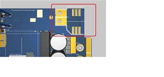

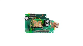

In the PMP22951 documentation, it seems there is a small break-off PCB in the top right corner that is intended to connect the transformer (PAT6289NL) to the SR card. However, in the photographs of the assembled board, this interconnect PCB looks different — it has rectangular holes for the SR card connections instead of the round ones shown in the PCB design files. Could you clarify which version is correct and if there is an updated design for this interconnect?

Also, on the assembled PMP22951 board, there is a yellow wire passing through CT100 and connected in place of CT101. Could you please explain what this modification is for?

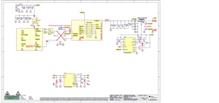

In the Altium Files rev.E - Project Outputs, there is a schematic file named PMP22951E(001)-Sch where components like T100, L100, L102, and others are not populated. Is this the final version of the design, or some kind of modification?

    1. The square PCB is what was used in the design. The small breakout board was for a different SR card that was using silicon SR FETs.

    4. This was to allow for the option to test with the current sense transformer either on the primary winding or in between the input caps and the primary side full bridge.
    5. T100 and L100 are both populated on the board. L102 was an option to place the current sense transformer on the secondary winding but this was ultimately not used in the final design.

    1. Would it be possible for you to provide the Gerber files specifically for the square PCB used in the final hardware (for the interconnect board)?

    1. Below is the interconnect board for connecting the transformer to the EPC SR card:
    /cfs-file/__key/communityserver-discussions-components-files/234/PMP22951-MX7-DC.zip
    There is an interposer card in between the SR card and main board to make it easy to plug into J102. Just in case it wasn't in the online files, Below is a zip containing the interposer:
    /cfs-file/__key/communityserver-discussions-components-files/234/EPC-SR-Interposer.zip

    I would like to kindly ask one more detail regarding the SR card connection:
    Are the SR card and the SR interposer simply soldered together via the pins, or is there a connector used between them?
    Additionally, if you happen to have any high-resolution photos of the fully assembled design showing the connections between all the boards, I would love to take a look at them.
    Thank you once more for your assistance and for sharing these excellent resources!
    Jaroslav
  • Hi Jaroslav,
    Below is the datasheet for the SR heatsink.
    /cfs-file/__key/communityserver-discussions-components-files/234/S08EHS0B.pdf
    The SR card and SR interposer are soldered together. There wasn't a convenient connector between these two unfortunately.
    I don't think I have any better resolution photos of the board unfortunately.
