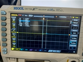

We are evaluating TI PMP41042 (3.6kW bi-directional CLLLC resonant converter reference design). For this evaluation board we are using TMDSCNCD280049C control card and using an in-card emulator for debugging purposes. By using it , we were able to run the Lab 1of F280049C successfully and getting the driver PWM with some dead band as shown in the below image :
