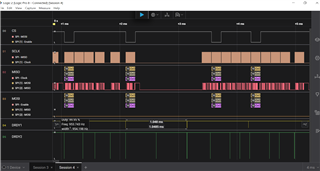

I am currently working on a project where I am referring to the TIDA-010087 software design. However, my hardware differs slightly: instead of a single ADS131M08 device as used in TIDA-010087, my project requires two ADS131M08 chips to handle 12 AC signals.

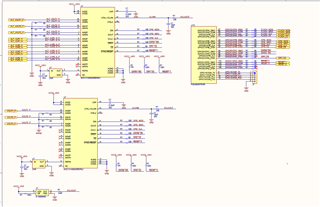

In my hardware design, I have connected both ADS131M08 devices to the SPIB port of the TMS320F28388S microcontroller, using separate chip select (CS) lines for each ADC.
My configuration is as follows:
  • ADC1:
    • DRDY → routed to ISR4
    • SPIB_RX → mapped to ISR7
  • ADC2:
    • DRDY → routed to ISR5
    • SPIB_RX → mapped to ISR8

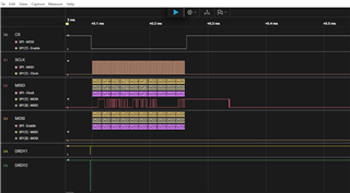

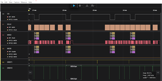

Currently, both ISR4 and ISR5 are triggering as expected when the DRDY signals go low.
However, only ISR8 (for ADC2’s SPIB_RX) is getting triggered. ISR7 (for ADC1’s SPIB_RX) is not triggering at all.
Could you please provide your expert guidance on what might be causing this issue and how to resolve it?
I have attached my software source file for your reference.
Looking forward to your valuable input.
