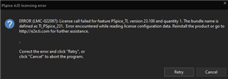

I keep re-installing the tool only for it to work for a little while then give me this pop-up. Is there permannent fix other than having to request a new download everytime?

Hi Joseph,
Please set up an environment variable to capture some debug information:
Create a new environment variable called “CDS_LIC_QA_TesT” and set it to a text file like this:

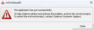

This is another issue. The simulation terminates and the application needs to either be restarted or I need to restart my PC.
does this happen on just one project? If so, please archive and share that project.
JC
This one has been happening over time across multiple projects. Seems probably more like a Cadence issue. If it happens again I'll try and get it to you. I haven't had the initial problem recur yet.
JC which file do you need? The license call just failed again. One thing to note is that it could be related to me working from home vs work.
To add to this. I was able to open it successfully when working on my PC from work vs Home just now. Seems to be related to where I'm at and what internet I might be using?
