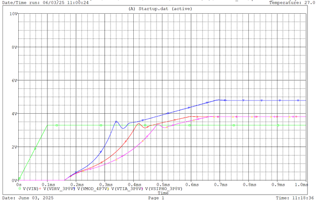

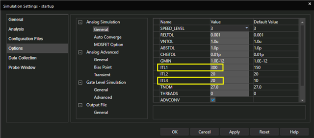

  • Hi Satoshi-san,
    I run the startup file in "TPS61023_4ch.zip" you attached on "Cadence Capture 17.4", with only the following two changes:
    1. Add SS = 0,
    2. Adjust the simulation parameters slightly
    Then the 4-channel simulation can run successfully. The result is shown below
    Please try the same 2 adjusts above on your simulation and run again. If there are still errors, I think the possible reason is than on PSpice for TI, the supported max number of simulation nets is limited.

  • Hi Satoshi-san,
    I attached the simulation files of the TPS61023 - 4 channels for your reference.
    This file is modified based on your file, with the only two changes mentioned in my last post. This file can run successfully on my side.

  • Hi Mulin,
    I tried it on multiple PCs and saw no improvement.
    The user requested that the simulation conditions be relaxed.
    Thanks to the cooperation we had received up until now, we were able to carry out the simulation smoothly.
    We are still waiting for the user to check, but I think we have cleared the issue.
