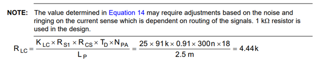

    Please explain why equation (14) in “5.2.6Current Sensing” results in 4.44 kohm, but the actual design (as implemented) is 1.0 kohm.

    2. As for the RLC selestion, there is a NOTE above the equation and it explained the reason for the 1kΩ:
