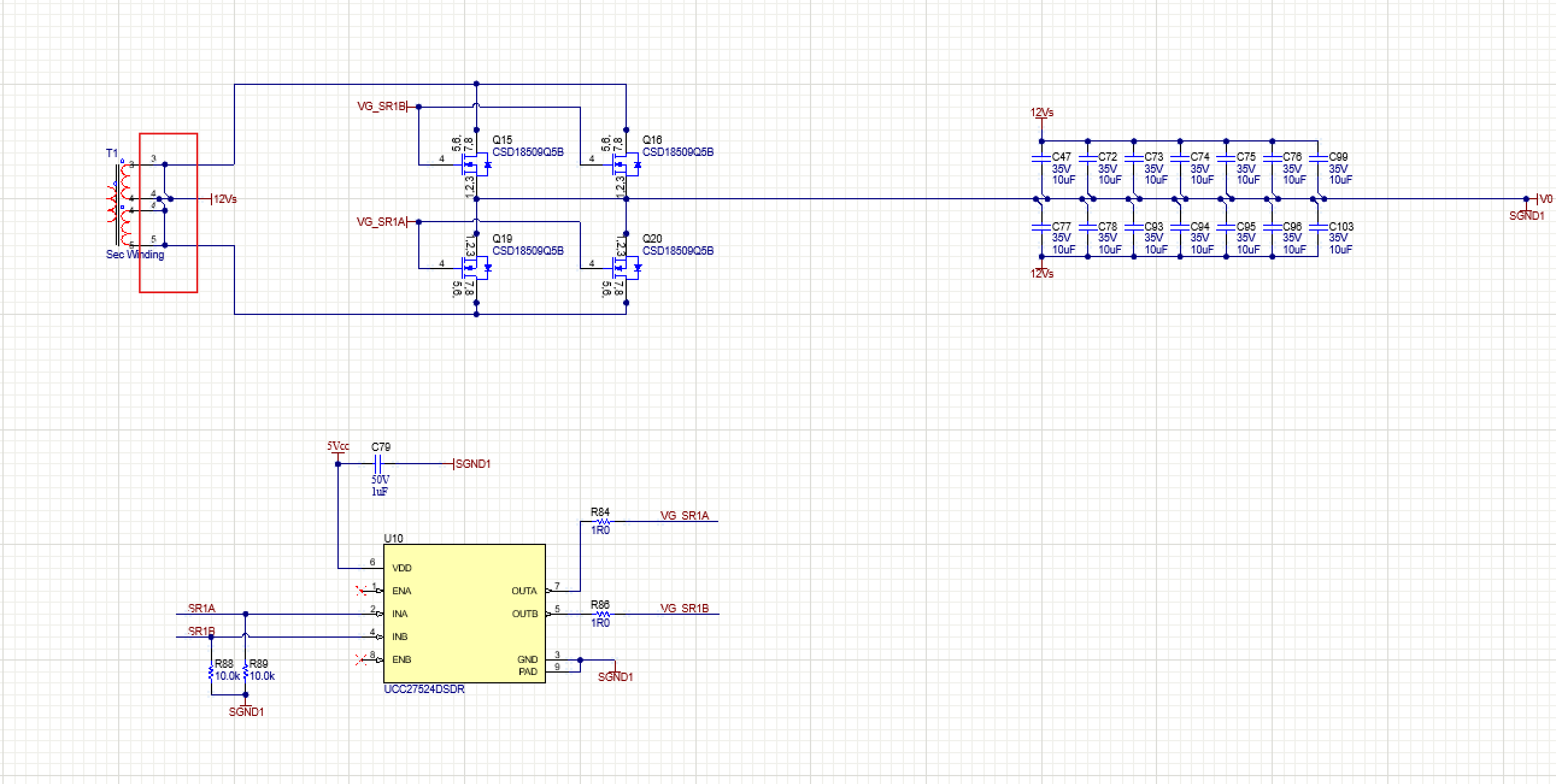

I found the SR Board design files in the zip file of the CAD/CAE symbols. I have a question, why is the transformer on the secondary side short-circuited, so that the transformer has no function.
This is is transformer winding board, so that is the winding coil arround the transformer core.
