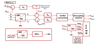

    4. Another point regarding the close loop current monitoring, the microcontroller has to compute the close loop function after reading the current through ADC at around 150Khz sampling frequency and updating the PWM duty cycle within the minimum PWM duty cycle such as 3nS. Please find below example of current vector processing.
    Is my assumption correct? Can you suggest a processor which can handle all above requirements?
