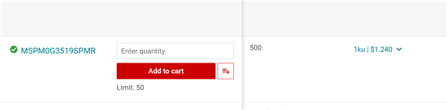

Hello , I was reach ing out the PCB manufactures and all of them complained about the MCU is out stock and I am now looking for alternative option . I saw multiple of chips what should I choose for the board tida-010247  XMSPM0G3519SPZR  , MSPM0G3519SPZR XMSPM0G3519SPNR as an alternative for the MSPM0G3519SPMR as this is out of stock right now even to order and how can I get free samples from them for our prototyping.

    I saw G3519SPMR has 500 inventory in ti.com. But I do find they are out of stock in 3rd party platform.
    If your PCB manufacturers cannot order in ti.com or it has very long lead time. You can reach out to TI Sales/FAE in your region or Arrow sales/ FAE for free samples.
    Or, you can choose MSPM0G3507 for alternative if you can accept 128kb memory and 1 CAN-FD. This device has inventory in 3rd party platform and is pin-2-pin with G3519.
