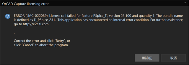

PSPICE-FOR-TI: About the installation of PSPICE-FOR-TI
Part Number: PSPICE-FOR-TI
Dear Support Team,
There was a problem with the previous download of the installation package to reinstall, double click EXE icon does not have any response.
So, I downloaded the latest installer from the official website, and it will prompt
"You have reached the concurrent device access limit.
Too many devices are attempting to connect with the same access key."
Please help to deal with this problem, thank you very much.
My e-mail is hanchongxiu@jcdz.cc
Thank you!

  • "PSpice for TI" installation was successful, and the program version is 17.40.9.
    However, double-clicking "PSpice for TI.exe" still yields no response.  The company's colleagues have ruled out other possible restrictions, but it still cannot be opened normally. Earlier, an attempt was made with version 23.10, and again, there was no response after double-clicking.
  • Hello, please install the latest version. You can uninstall 17.4, then reboot the system and install the latest. If it still doesn't work, please generate a debug file to help us troubleshoot:
    1. Create a new environment variable "CDS_LIC_QA_TesT". Set it to something like "C:\Cadence\PSpiceTI\LicLog.txt".
    2. Run PSpice for TI, wait for some time, then check if the file "C:\Cadence\PSpiceTI\LicLog.txt" is created.
    3. share the file LicLog.txt
    4. Delete the environment variable "CDS_LIC_QA_TesT".
    JC
  • 1.I tried the measures“Create a new environment variable "CDS_LIC_QA_TesT". Set it to something like "C:\Cadence\PSpiceTI\LicLog.txt".
    Run PSpice for TI, wait for some time, then check if the file "C:\Cadence\PSpiceTI\LicLog.txt" is created.”, but no LicLog.txt was automatically created on the C drive.
    2.To further rule out the possibility, I uninstalled Cadence 17.2, fearing that it might have affected PSPICE FOR TI 2023 (the program installation package corresponding to version 17.4). However, this concern was unnecessary.
    3. I reinstalled PSPICE FOR TI 17.4 to the D drive, but still, when I double-clicked it, there was no response. The *.DSN file was not connected either, and the LicLog.txt file was not created either.
    4.I installed Cadence 17.2 on the C drive. When I opened ORCAD_CIS.EXE at this time, I saw that LicLog.txt had been created. The content indeed contained the startup log, indicating that my environment change should have been successful. However, unfortunately, it was not generated by PSPICE FOR TI.
    5.On the computer in my home,Since Cadence 17.2 was installed on drive D and PSPICE FOR TI 2024 was installed on drive C, both programs are functioning properly. I simply copied all the files from the C drive where PSPICE FOR TI2024 was installed to the USB drive, and then brought it to the company computer. When I double-clicked captur.exe, an error message appeared.  At least this indicates that it is functioning.
  • in step 1, is it a location that you have write permission to?
    in step 3, how did you install PSpice for TI 17.4? The only package available online is 24.1. Please always use the latest installer, not the installer saved before. Version of installer does not affect version of the package being installed but may cause issues if it is older than the package.
  • 1,environment variable
    2, Run as administrator
    3,The antivirus software has been exited and the firewall has been turned off. When preparing to download from the server, the system crashed.

  • Are you installing in a virtual machine?
    -JC
  • No, it was installed on my local D drive. But why can 17.4 be downloaded and installed (but it doesn't work properly), while 23.10 cannot be installed? Can any issues be seen in the installation log?
  • Do you have both PSpice for TI 17.4 and 23.10?
  • 1. No, every time it is uninstalled and then installed. It's just that I can only install 17.4 on this computer. 23.10 fails at the download stage.
    2. Today I got a new laptop that can install 23.10, but unfortunately it still won't boot properly.
    3. My computer only has cadence 17.2 installed, but I also tried to uninstall it and arrange it again without success. Now I can only suspect that there is something wrong with my computer.
    4. Now I have uninstalled cadence17.2 in my laptop and am trying to install 23.10 for the second time.
  • Are you referring to the version of "PSpice-For-TI_setup.exe"? If so, that is the installer, not the software itself. The installer downloads the software package from the web and currently the package available is 23.1-2024-S001. Please use the latest version of "PSpice-For-TI_setup.exe" to install.
    What's the error message when you try to launch it?
