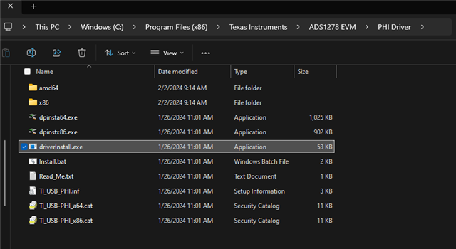

  • Hello Joseph,
    Welcome to the TI E2E community.
    You may have anti-virus software preventing the driver from installing correctly.  You can try to manually install the hardware driver by navigating to the following directory and launching the driverInstall.exe file:
    C:\Program Files (x86)\Texas Instruments\ADS1278 EVM\PHI Driver
    Also, do not connect the EVM through a USB hub; directly connect it to one of the ports on your PC.
    If you are still not able to get this to install, then you may want to try a different workstation.
    Please let me know if the you are able to get the EVM working.

  • Hi Keith,
    Thanks for your reply. It doesn’t seem my antivirus is blocking the driver install. I notice that my version of the EVM software is missing the batch file, driverInstall executable, and readme. I was able to run the DPInst64 executable, but this did not fix the issue. Is there another version of the software available I need to access?
