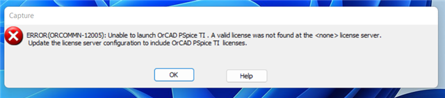

PSPICE-FOR-TI: Installation isuess
Part Number: PSPICE-FOR-TI
1. i already run it in admin mode still like this
2. restart pc also didn't work.
3. I tried several networks but still unable to install Pspice
  • Please reboot your PC and try again and create a debug file and share it with us if you still have trouble:
    • Create a new environment variable "CDS_LIC_QA_TEST". Set it to something like C:\Cadence\PSpiceTI\LicLog.txt where you have write permission to.
    • Run PSpice for TI if installed or the installer if not, wait for the error message to be shown, then check if the file C:\Cadence\PSpiceTI\LicLog.txt is created.
    • share the file LicLog.txt
    • Delete the environment variable "CDS_LIC_QA_TEST". (otherwise LicLog.txt will keep growing).
