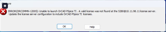

PSPICE-FOR-TI: report an eroor.
Part Number: PSPICE-FOR-TI
Previously, PSPICE could be used normally, but today morning there was an error as shown in the image below. I restarted my computer and reinstalled PSPICE software, but still got the following error. The same goes for changing my computer. Please help handle it.
7776.qalog.txt
  • Please reboot your PC and try again and create a debug file and share it with us if you still have trouble:
    • Create a new environment variable "CDS_LIC_QA_TEST". Set it to something like C:\Cadence\PSpiceTI\LicLog.txt where you have write permission to.
    • Run PSpice for TI if installed or the installer if not, wait for the error message to be shown, then check if the file C:\Cadence\PSpiceTI\LicLog.txt is created.
    • share the file LicLog.txt
    • Delete the environment variable "CDS_LIC_QA_TEST". (otherwise LicLog.txt will keep growing).
