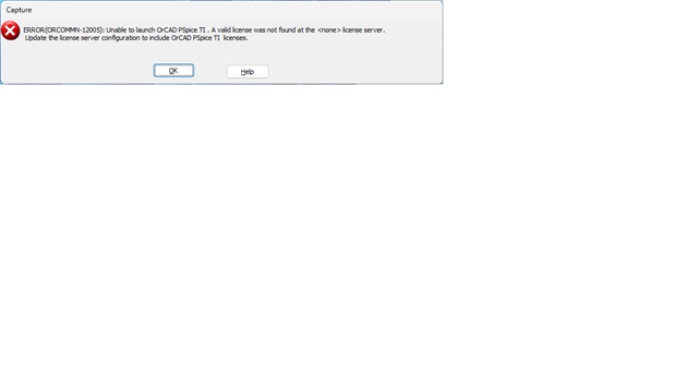

I installed Pspice for TI on a new PC and got the error shown in the attached image.
I installed it with administrator privileges.
Could you please tell me the necessary environment variables and their values?
I'm not sure if CDS_LIC_FILE is required, but it's not set on my current PC.
  • Please reboot your PC and try again and create a debug file and share it with us if you still have trouble:
    • Create a new environment variable "CDS_LIC_QA_TEST". Set it to something like C:\Cadence\PSpiceTI\LicLog.txt where you have write permission to.
    • Run PSpice for TI if installed or the installer if not, wait for the error message to be shown, then check if the file C:\Cadence\PSpiceTI\LicLog.txt is created.
    • share the file LicLog.txt
    • Delete the environment variable "CDS_LIC_QA_TEST". (otherwise LicLog.txt will keep growing).
