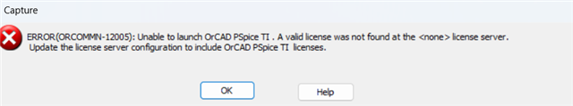

Hi team,
A customer is having difficulty with launching PSpice. Previously it was working. Screenshots below. What could be happening here and what do they need to check to make it work again?
Randy
  • Please reboot your PC and try again and create a debug file and share it with us if you still have trouble:
    • Create a new environment variable "CDS_LIC_QA_TEST". Set it to something like C:\Cadence\PSpiceTI\LicLog.txt where you have write permission to.
    • Run PSpice for TI if installed or the installer if not, wait for the error message to be shown, then check if the file C:\Cadence\PSpiceTI\LicLog.txt is created.
    • share the file LicLog.txt
    • Delete the environment variable "CDS_LIC_QA_TEST". (otherwise LicLog.txt will keep growing).
