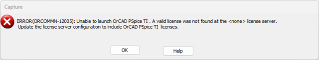

I downloaded PSPICE for TI last week, and it has been working fine until this morning, when I launched it and got the following error:
After doing some research, I have tried the following:
- Reinstalled Pspice for TI
- Disabled my VPN (I do get a successful connection from Test Connection)
- My licence.txt file is present and in the correct directory
- I am logged in as the same user as when I originally installed
Any advice on how I can resolve this issue would be appreciated.
  • Please reboot your PC and try again and create a debug file and share it with us if you still have trouble:
    • Create a new environment variable "CDS_LIC_QA_TEST". Set it to something like C:\Cadence\PSpiceTI\LicLog.txt where you have write permission to.
    • Run PSpice for TI if installed or the installer if not, wait for the error message to be shown, then check if the file C:\Cadence\PSpiceTI\LicLog.txt is created.
    • share the file LicLog.txt
    • Delete the environment variable "CDS_LIC_QA_TEST". (otherwise LicLog.txt will keep growing).
    thanks,
    JC
  • It seems to have been resolved along with the license service restoration.
