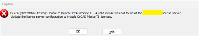

Unable to launch PSPICE after installation. Below error is popping up. It is saying as license not found. Could you Please help on the same?

  • Please reboot your PC and try again and create a debug file and share it with us if you still have trouble:
    • Create a new environment variable "CDS_LIC_QA_TEST". Set it to something like C:\Cadence\PSpiceTI\LicLog.txt where you have write permission to.
    • Run PSpice for TI if installed or the installer if not, wait for the error message to be shown, then check if the file C:\Cadence\PSpiceTI\LicLog.txt is created.
    • share the file LicLog.txt
    • Delete the environment variable "CDS_LIC_QA_TEST". (otherwise LicLog.txt will keep growing).
