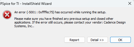

When I try to launch the .exe file downloaded from the TI website, I have this error message:
What is this issue? and how i can resolve it

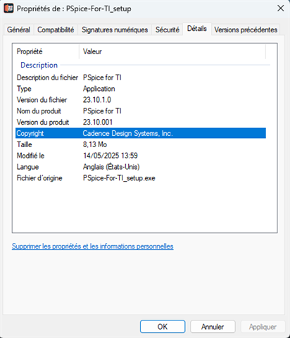

  • Hi Mouhanned,
    Where did you get the installer from? Can you confirm its property?
    JC
  • Hi JC,
    I get it from TI website. When i look at the property of the installer i get the same features as you:
    Mouhanned

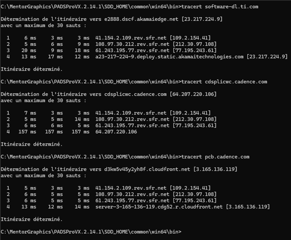

  • The PSpice for TI installer accesses the internet to download and install various packages. Before starting the installer, ensure the following:
    	1.	Internet connection is available
    	2.	Security protocol TLS 1.2 is enabled
    	3.	Following endpoints or resource locations are accessible from the system:
    		a.	https://pcb.cadence.com/startPages
    		b.	https://software-dl.ti.com/pspice
    		c.	https://cdsplicwc.cadence.com/chws
    If proxy credentials are required to access the Internet, provide the same when requested by the installer.
    08:58:41 jeudi 15 mai 2025 : *****CONNECTION STATUS CHECK*****
    08:58:42 jeudi 15 mai 2025 : Internet Connection : Not Available (Failed)
    08:58:41 jeudi 15 mai 2025 : parameter count = 1
    08:58:41 jeudi 15 mai 2025 : -wrapper
    08:58:42 jeudi 15 mai 2025 : Message: Cannot connect to server because there is no Internet connection. Check Internet connection of the system and run installer again.
  • Hi Mouhanned,
    What is your network connection? The error message suggests that there isn't one:
    -JC

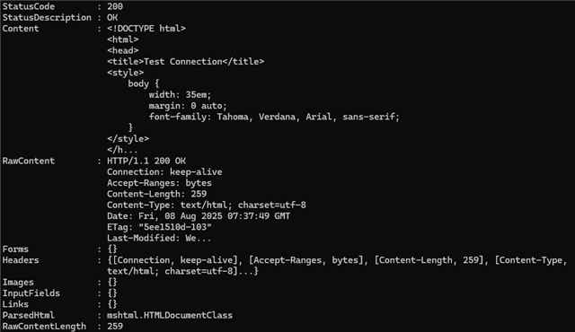

    Would you please start a Windows PowerShell and type the following commands in?
    wget https://cdsplicwc.cadence.com/chws/test/connection.html
    JC
  • HI JC,
    This is the result
    Mouhanned
  • Hi Mouhanned,
    Is this a company PC or personal? Is it inside a VPN/Firewall?
    JC
  • Hi JC,
    It is a company PC. I asked for the firwall and the three locations required for the installation:
    are deblocked as you can see below
    But i have the same error
    Mouhanned
