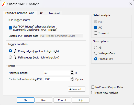

I got problems when I simulate the TPS548B22 under SIMPLIS. The pop analysis always fails when I want to simulate the closed loop characteristics. Pls help me with the simulation model.  https://e2e.ti.com/cfs-file/__key/communityserver-discussions-components-files/234/TPS548B22_5F00_TRANS_5F00_Steady_5F00_State.sxsch
    You will need to run the transient analysis first, this will establish the DC operating point for the simulation.
    After you have run the transient analysis, you can run the  POP and AC Analysis.

    I've checked the simulation order which is AC analysis after transient analysis, but the error still occurs. I suspect there exist inadequate simulation parameters in it. Would you mind help me check the simulation model. I would appreciate it if you can help!
    I made some adjustments to get it to converge.  I am working through the adjustments I made to see what the minimum number of changes are to get it to work.

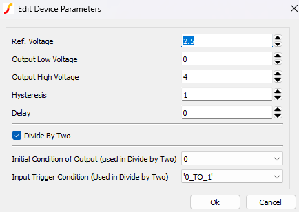

    1) Update the POP Trigger element to use a threshold voltage of 2.5V and the "divide by 2" option
    2) Update the Pop Analysis settings for a 5μs maximum period (needs to be longer than 2 switching cycles due to the divide by 2 on the POP trigger)

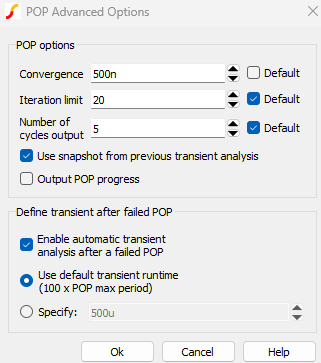

    3) In the Advanced Pop Settings increase the Convergence threshold from 1p to 500n and check "Use snapshot from previous transient analysis"
    That should allow you to run the POP and AC analysis on the schematic.
