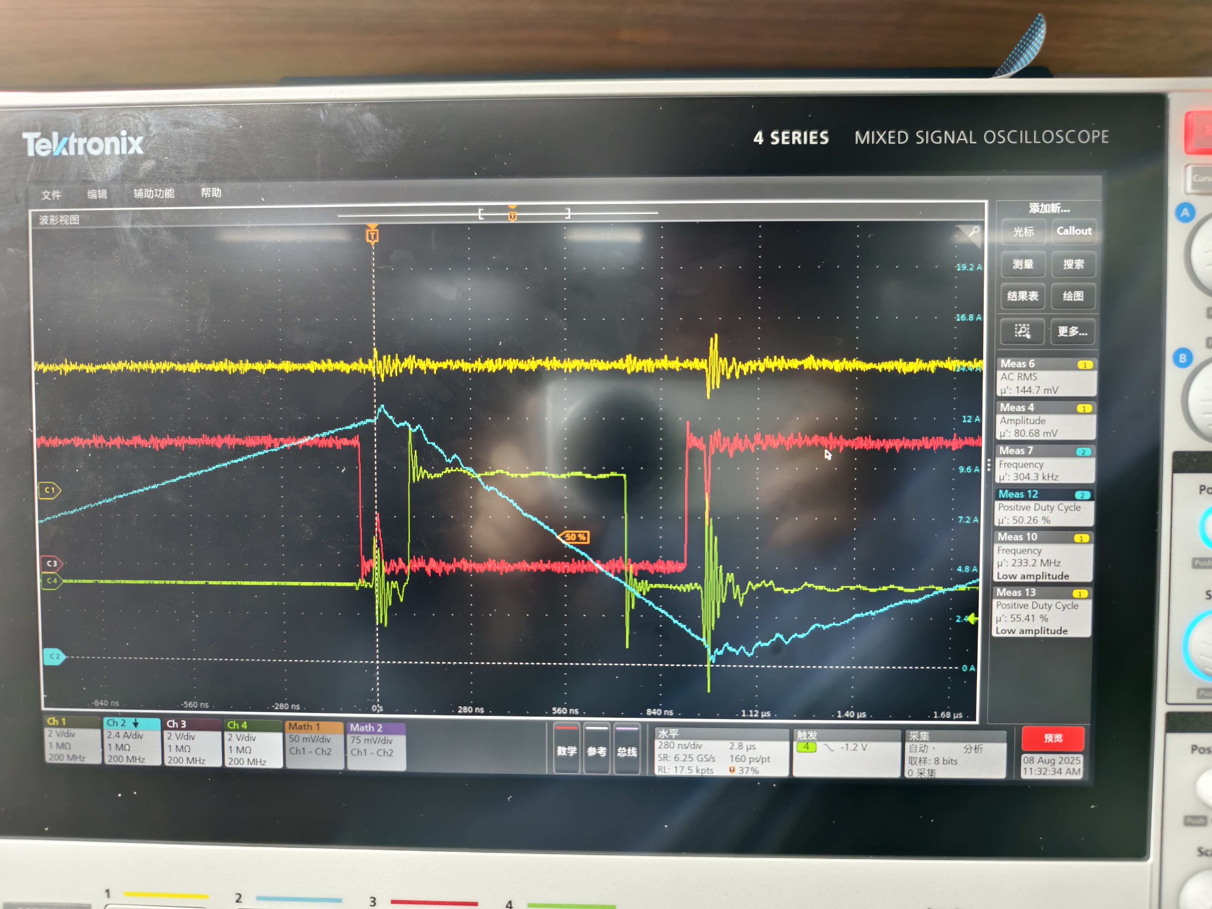

we used the reference pcb files make the board, found that when the single-board power exceeded 250W, the peak and valley values of the inductor current would affect the GaN drive signal,generate ringing, causing the device to overheat
