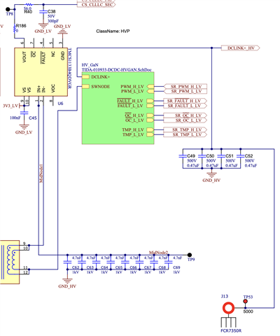

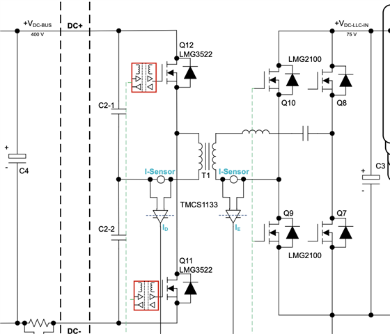

I was confused about the voltage gain of the CLLLC transformer T1. The turns ratio shows 4: 11 in transformer doc.
And C2-1, C2-2 can double the voltage gain, so 75V can reach to 400V.
But I find there have no capacitors like C2-1, C2-2 can double the voltage gain in the detial schematic diagram.
So, I wanna know the finnal plan how you make the 75V boost up to 400V.
