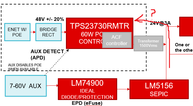

For the PMP23287, using the Active Clamp Forward controller inside the TPS23730, does this circuit have any issue with 24V being present on the output but the TPS23730 disabled via the APD input?
A customer will have a separate power converter stage for the auxiliary input but needs to maintain isolation between the PoE path and this auxiliary path.
PMP23287 uses self-driving synchronous rectification to deliver 24V @ 2.5A.
Will this have issues with no switching from the TPS23730 but with 24V present on the output?
