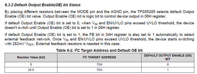

Is the USB2ANY required to run the TPS55285EVM? Can this EVM work without it?

    By setting mode pin resistor to 24.9kohm, TPS55285 can start up without a USB2ANY. All registers are default and unchangeable. Recommend to use a USB2ANY for more functions.

    We were able to start the board. However, the Vout we are getting is ~2.85V, which makes sense based on the VREF: 0.3V, RFB_UP: 102,049 ohm, and RFB_BT: 11.3Kohm.
    Is it possible to modify the VREF without the USB2ANY? We want to test the different loads based on Table 1-2 of the EVM:

    VREF cannot be changed without a USB2ANY. You can change RFB_BT to change target Vout.
