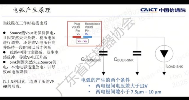

I leveraged this solution and try to win more TI sockets to my customer. And customer hopes to know how we to deal with the arc caused by high voltage when pulling out the Type C device.
here is the picture customer shared with me to explain the issue.
Key translation:
When a cable is unplugged during operation.
  • The source side's Vbus remains powered, and due to the sudden loss of load, the regulated power supply adjusts, causing the Vp voltage to rise. This voltage remains elevated for a while before shutting down.
  • The sudden drop in current in the line causes inductive kickback, causing the Vp voltage to rise.
  • The sudden loss of source power on the sink side causes the local capacitor to discharge rapidly, causing the VR voltage to drop.
These three factors create a voltage difference: VP - VR.
Two conditions for arc generation:
  • The voltage difference between the two electrodes is greater than 12V
  • The gap between the two electrodes is less than 7.5µm - 10µm
