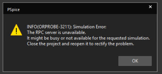

Part Number: PSPICE-FOR-TI
Following error message popped up while initiating the simulation
Already tried  below workaround as mentioned in one of the thread
  • Hi Vishnu,
    Does this happen with just one project or all projects?
    JC
  •   It happens with all projects. Tried reinstalling the software but didn't worked
  • Hi Vishnu,
    Is it right after Windows starts or after running for some time?
    I'd try restart Windows as a first check. If no luck, please try the following:
    Delete following registry from registry editor:
    HKEY_CURRENT_USER\Software\Orcad\CaptureTIPSpice_Install\17.4.0
    If you are running the latest version, delete this:
    HKEY_CURRENT_USER\Software\OrCAD\CaptureTIPSpice_Install\23.1.0
    If that doesn't work:
    Rename capture.ini to capture_ini.txt at %cds_home%\cdssetup\ORCAD_CAPTURETIPSpice_Install\17.4.0
    Rename pspice.ini to pspice_ini.txt at %cds_home%\cdssetup\OrCAD_PSpiceTIPSpice_Install\17.4.0
