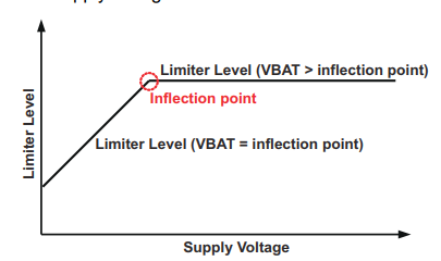

  • Hi Kyohei,
    it seems the issue is the output volume. the output volume is affected by the input signal, gain setting, AGC(if used) etc.
    from the analyzing step, it seems it is focused on the gain setting. in this case, have you checked the output signal/input signal? if AGC is used, how about the VBAT voltage setting, and the VBAT voltage under test?
    it's better there is some data about the electrical output signal difference. check the AMP input signals, and the vbat voltage level. these data will help to analyze the issue.
    if this is not a HW issue, maybe it could be related to the VBAT voltage by AGC like below:
