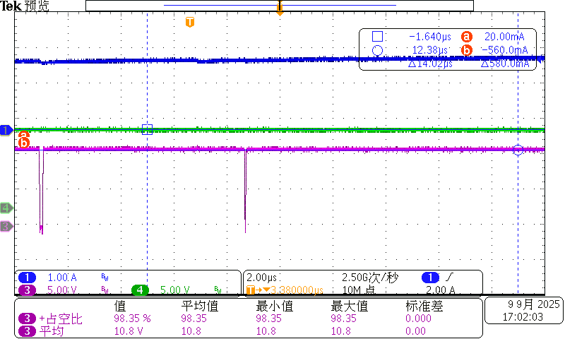

From my measurements, it appears that during clipping, the OUTNL/OUTNR duty cycle can reach 100%. I would like to confirm whether this IC is indeed capable of achieving a full 100% duty cycle.

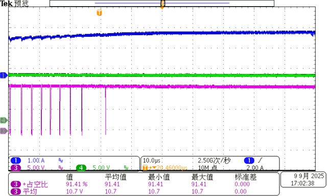

Attached are three waveform screenshots showing the duty cycle approaching 100% during clipping. Could anyone confirm if my observation is correct or if there is something I might be overlooking in this configuration?

    Also, please note that we are not using the EVM. The testing was performed on our own PCB. In the waveforms I shared earlier, the blue trace represents the 12V supply, while the green and purple traces represent the L and R outputs. As you can see, both channels are running at a duty cycle very close to 100%, which is the part I find confusing and would like to confirm with you.

    Oh sorry I misspoke I was thinking the device had a different modulation scheme. This device is using BD modulation - so 100 % duty cycle is possible but should be avoided. Essentially this is pushing the output stage outside of the linear region so it is not ideal.
