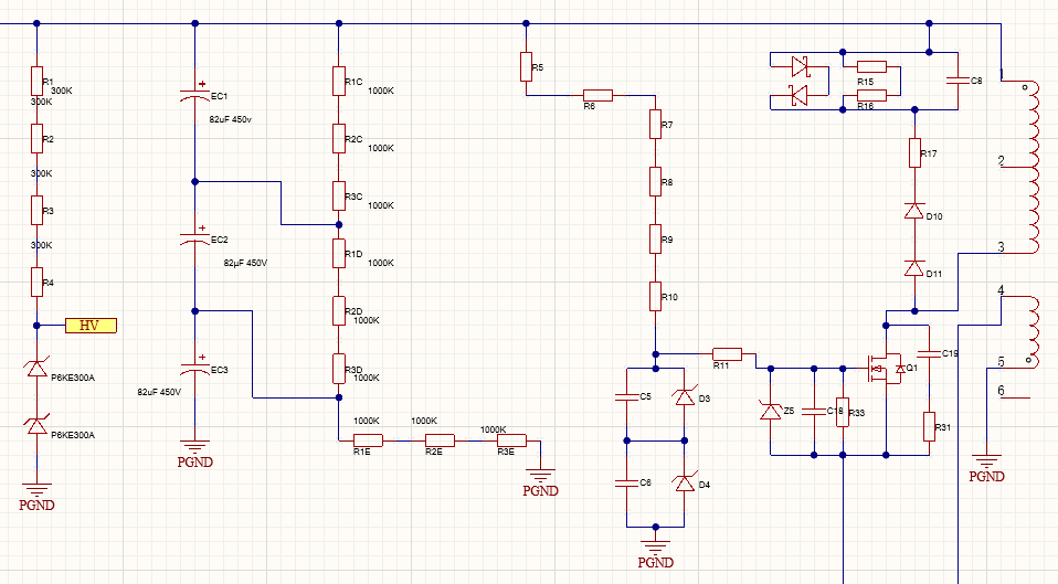

Hello, I am debugging a self-designed flyback switching power supply with an input of 90-900VAC and an output of 24VDC. I use the UCC28740 chip and adopt the relevant power supply circuit from the PMP41009 design. Why is it that when the input is 220VAC, the voltage after rectification is 328VDC, the measured voltage at the HV pin is 12V, the chip fails to work normally, and the voltage at the VDD pin is only 1.3V? No changes have been made to the circuit. Below are the relevant power supply circuit from the PMP41009 design and the power supply schematic diagram of my input voltage after rectification. The turns ratio of the transformer is 20:5:6, Rvs1=160kΩRvs2=24kΩ.Could you please advise on how to solve this problem?I also asked this question last Monday, but when replying to your inquiry, I couldn’t upload images or send messages at all, and it’s only now that I can do so.
    1. Double check the resistance of R1~R4
    2. Remove P6KE300A and short R1~R4, check the VDD voltage, and power up UCCC28740. UCC28740 HV pin ABS voltage is 700V, make sure the voltage after rectification is lower than 700V when do this testing.
    3. Place P6KE300A back to check the HV voltage.
  • I have performed the following operation before: I removed the P6KE300A, short-circuited resistors R1 to R4, and connected the HV pin directly to the rectified circuit. At this time, the input voltage was 387VDC after rectification, the voltage at the HV pin was 10.5V, and the voltage at the VDD pin was 1.4V—there was no change. Reconnecting the P6KE300A also resulted in no change. Is this phenomenon related to the values of RVS1 and RVS2?
  • When you short R1 to R4, then the net after rectification should be same with HV, why are the voltages different?
  • Hello, when R1 is short-circuited to R4, the voltage at the HV pin is 357VDC—I made a mistake earlier about this value. However, the voltage at the VDD pin is still 1.4V. Could you please tell me where the problem might be?
  • Could you share the schematic included the UCC28740?
