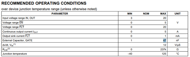

The TIDA-00890 BOM (tidrk60) item 6 (C11) is 47nF.
However, the description of item6 says CAP CER 4700PF 25V X7R 0402.
I think this is a typo and should be 47nF. Is this understanding correct?
C11 is connected to the GATE pin of the TPS25910.
On the other hand, the 3220DFP-DGLEVM appears to be similar to the TIDA-00890, but the capacitor value connected to the TPS25910's GATE pin is 47nF.
