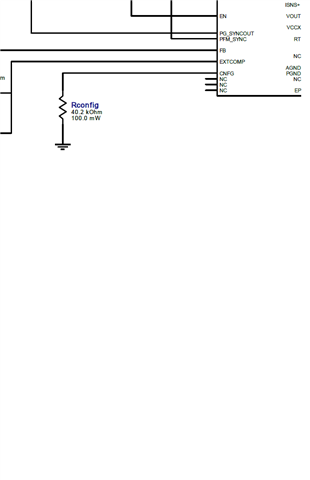

Hi, I hate to be pedantic but I found some minor issues with the Webench design for LM5148
* The 'Rconfig' in the Webench is specified as 40.2K, which will work but it's the minimum resistor value and should be 41.2K instead.
* The generated output design shows some of the NC is not connected to ground, The datasheet specifies that those pins should be connected to ground to help with heat dissipation.
Here is a link to the design I'm working with: LM5148 14V-60V to 5.0V @ 6A
I don't think these would be 'show stoppers' but these could be fixed.
