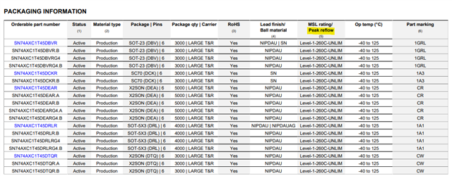

Part Number: SN74AXC1T45
Hi can you give me the Recomended stencil thickness , aperture / pitch and the recomended temperature for Re-flow ?

Hello Gusti,
You can see recommended temperature re-flow here:
The recommended stencil design will depend on your package. This is located at the bottom of the datasheet. Thanks!
