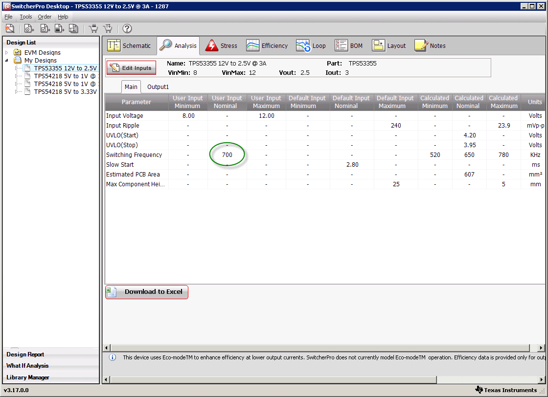

I want to simulate a design with TPS53355 with high switching frequency.
The switching frequency is controlled by a resistor from pin "RF" to either ground or VREG.
In the design in SwitcherPro (v3.17.0.0 downloaded today) there is only one resistor to ground.
Hence, no frequencies larger than 500KHz can be simulated.
Is that right, or do I miss a way in which I can add a resistor between "RF" and VREG?
