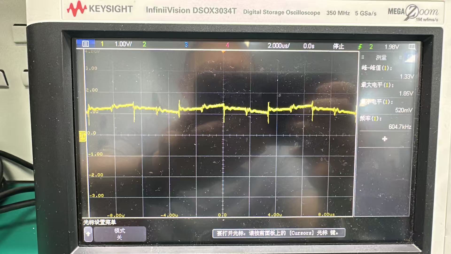

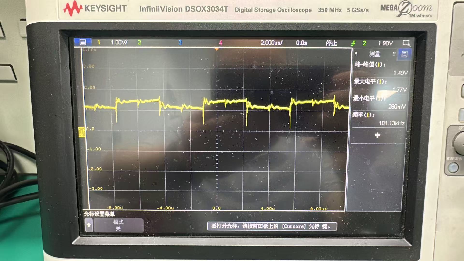

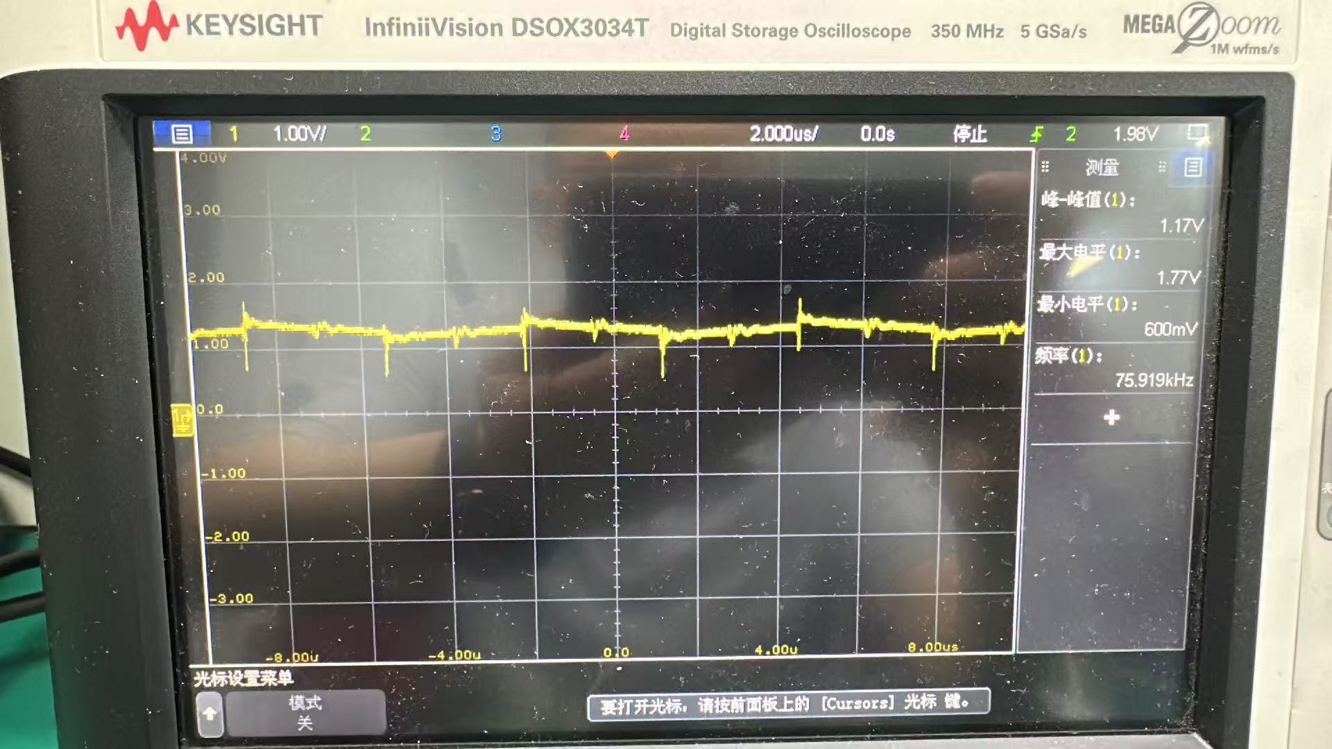

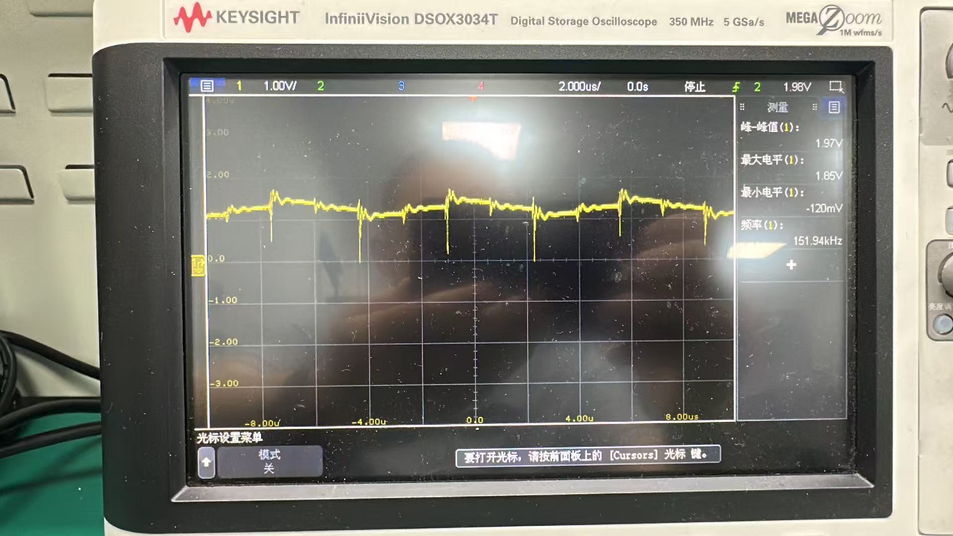

We use LM5171QPHPRQ1 designed12V-24V bidirectional DCDC. Now we found some issues during debugging:
  1. Could you help check the parameter selection is correct for current loop compensation, boost voltage loop compensation, buck voltage loop compensation that in attached LM5171_Buck_or_Boost_Quickstart_Tool_1.0.3_12V_24V? I have filled other basic parameters for our system design.
I used the components that calculated in the table, and measurement the COMP1, COMP2, COMP3, COMP4, FBHV wave as attached when in boost mode, We can clearly observe that these test points have distinct pulse spikes. I set DEM mode and no load in 24V side, the almost identical waveforms occur in the DEM mode and 1A load. Could you please help analyze this situation? How should I modify the compensation circuit, or the circuits of the power supply and the load side?

  • Hi Ran,
    1. The compensation looks good, but I am concerned about 100A per phase. Is the COMP signal tested with ground spring? Do you see any issues?
