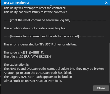

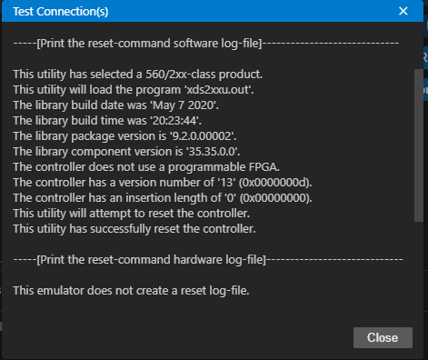

    Thank you for your guidance. Please find below the requested information and test results:
    1. Error Log Analysis
    The error code I am receiving is:
    Error -233 (0xffffff17) - please see the next screenshot
    2. Target Configuration (.ccxml)
    The target configuration has been verified with the following settings:
    • Connection: Texas Instruments XDS2xx USB Debug Probe
    • Device: AWR2x44P
    I also ran “Test Connection” from the Target Configuration editor.
    The failure occurs during the connection process (consistent with the -233 error), suggesting an issue in JTAG communication.

  • Hi Mihaela,
    Thank you for providing the detailed screenshots and test results. The error code and your test results now give us a much clearer picture.
    Key Finding: This is NOT an XDS200 Hardware or Firmware Problem
    The error -233 (SC_ERR_PATH_BROKEN) with title SC_ERR_PATH_BROKEN has a specific meaning:
    "The JTAG IR and DR scan-paths cannot circulate bits, they may be broken. An attempt to scan the JTAG scan-path has failed. The target's JTAG scan-path appears to be broken with a stuck-at-ones or stuck-at-zero fault."
    This error means the emulator itself is communicating correctly, but it cannot see a valid JTAG scan chain on the target side. The probe is working — the target JTAG path is not responding correctly.

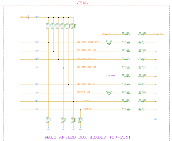

    • Verify your custom board schematic for correct JTAG termination on the AWR2x44P:
      • TMS — requires pull-up (typically 10kΩ to VDDIO)
      • TDI — requires pull-up (typically 10kΩ to VDDIO)
      • TDO — should not be pulled high or low aggressively
      • TCK — requires pull-down (typically 10kΩ to GND)
      • nTRST — must not be held low; requires pull-up if used

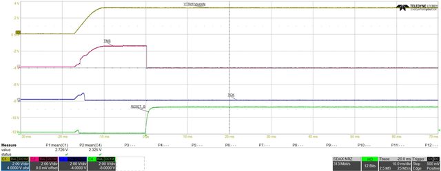

    Thank you for the detailed explanation — it helped narrow things down further. I’ve gone through the checks you suggested, and here are my findings:
    1. and 2.  VTREF Measurement and Signal Comparison
    I measured VTREF, TMS, nRESET, and TCK on the custom board using both debuggers:
    • XDS110 (working)
    • XDS200 (failing)
    XDS110:
    XDS200:
    I have also attached a picture indicating exactly which pins were measured:
    Additional Observation
    During testing, I noticed a consistent difference in behavior between the two debuggers when performing a hard reset of the power supply:
    • With the XDS110 connected:
      • The consumption remains around 1.5 V
      • TMS stays at ~3V+
    • With the XDS200 connected:
      • The consumption drops to approximately 0.6 mV
      • TMS drops to 0 V
    This difference appears consistently and may indicate a variation in how the two debuggers drive or hold the JTAG lines during reset.

    Thank you — this new data is extremely revealing. The voltage behavior you observed is the key to diagnosing the root cause.
    Critical Finding: XDS200 is Loading Down Your VTREF / Power Rail
    The symptom you captured is diagnostic:
    Condition VTREF / Supply TMS
    XDS110 connected ~1.5V (normal) ~3V+ (normal)
    XDS200 connected ~0.6 mV (collapsed) 0V (pulled low)
    When you connect the XDS200, VTREF (Pin 1 of ARM20) collapses to near zero. This is not a firmware or software issue — the XDS200 is drawing excessive current from your VTREF line, causing the voltage to collapse entirely. This immediately explains the SC_ERR_PATH_BROKEN error: the probe cannot establish JTAG levels because its own voltage reference has been pulled to ground.

    2. ARM20 Pin 1 (VTREF) Must Be a Low-Impedance Supply
    This is the most common custom board JTAG design error. The VTREF pin must be connected to a low-impedance voltage supply (direct connection to VDD_IO or equivalent), not:
    • A voltage divider output
    • A weak pull-up
    • A filtered/RC-decoupled node
    The XDS110 likely works because it has a higher input impedance on its VTREF pin or does not rely on it as heavily for its internal buffer supply.
    Immediate Action Items
    Step 1 — Measure VTREF Source Impedance
    With the board powered and no debugger connected, measure the voltage on Pin 1 of your ARM20 connector. It should read the full target I/O voltage (1.8V or 3.3V depending on AWR2x44P I/O bank configuration).
    Then, with the XDS200 connected but before pressing Test Connection, measure again. If it drops immediately upon physical connection, this confirms excessive loading.
    Step 2 — Check Your Custom Board Schematic for ARM20 Pin 1
    Trace where Pin 1 (VTREF) of your ARM20 connector is connected on your custom board. Verify:
    • It is connected directly to a power supply rail (VDD_IO or 3.3V/1.8V)
    • It is not behind a current-limiting resistor (any resistor > ~100Ω will cause significant voltage drop under XDS200 load)
    • It is not a divided reference
    Step 3 — Check for Series Resistor on VTREF
    Some board designs inadvertently place a protection resistor (e.g., 10Ω–100Ω) in series with VTREF. Under the XDS200's VTREF current draw (~10–20 mA), even a 10Ω resistor can cause a meaningful drop. A 100Ω resistor with 10 mA draw would collapse the voltage entirely on a low-current source.
    Step 4 — Temporary Workaround to Confirm
    If you have access to a bench power supply or a strong 3.3V/1.8V rail on your board, try directly wire-bodging Pin 1 of the ARM20 connector to that rail to bypass any impedance in the current path. If the XDS200 then connects successfully, this confirms the supply impedance is the root cause.

    VTREF collapses to ~0.6 mV with XDS200 VTREF source on custom board is too high impedance
    TMS drops to 0V Direct consequence of collapsed VTREF (level translators unpowered)
    XDS110 doesn't cause collapse XDS110 draws negligible current from VTREF
    Error -233 SC_ERR_PATH_BROKEN Expected result when VTREF = 0V (no JTAG signals possible)
