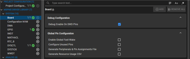

is there a way to extract a CSV or some kind of overview of the Pinmux configured in SysConfig/CCS?

Note that the ticket is for a generic feature. But depending on the device and SDK, it may be available. Which device and SDK is being used?

this is MSPM0G3519 and latest MSP SDK version.

Thanks. I will bring this thread to the attention of the device/SDK experts to see there is something for that environment.
