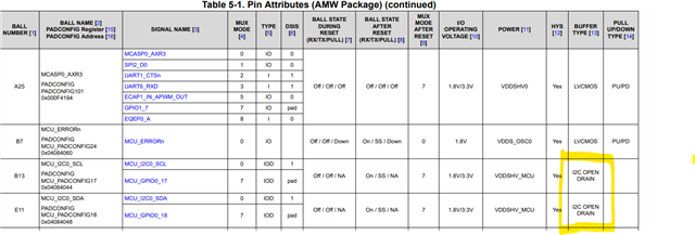

I have a question regarding the J722S IBIS model that is publically provided. From what I understand the IBIS model used for the Main Domain I2C0_XX called LVCMOS_V. I want to confirm if this is the correct model is to use and not the IIC_V model that is used which I believe is dedicated the MCU domain MCU_I2C0_XX and acts as a true I2C open drain model..

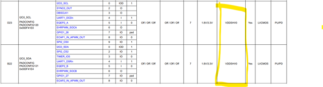

From what I understand the I2C0 is an Push Pull LVCMOS bus that is emulated to act as an open-drain when driven high. From what I deciphered LVCMOS_V are the models used for LVCMOS Emulated Open Drain buffers (IOD - LVCMOS), and the LVCMOS_H are the models that act as standard LVCMOS Push Pull IO. For LVCMOS_V I assume I can drive the buffers they can be converted from push-pull to OD, also if I were to use the LVCMOS_V I assume I would have to shut off the internal source, or the model will drive the symbol correct?
  • Hello Nicolas Rancher,
    Thank you for the query.
    This is correct.
    Please refer inputs i received from the experts:
    LVCMOS_H and LVCMOS_V refer to the orientation of the IO within the IO ring – H for horizontal and V for vertical. Both have the same functionality that can be controlled by appropriate buffer tie-offs in the simulation setup.
    To emulate the open-drain function, we simply tie the input of the output buffer low and connect the I2C output signal to the output enable of the output buffer.  In this usage of the IO, the high driver is never turned on.  When the output is driven low, the low driver will perform the same way it does in push-pull mode.  I would expect customers to use the same IBIS model and simply connect the buffer in their simulations as described above.
