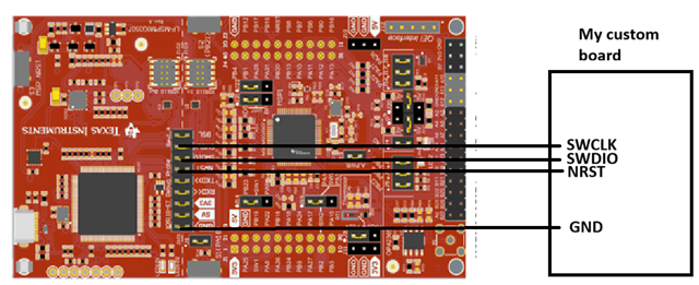

    Regarding your suggestion to connect the target's 3.3 V rail to the XDS110 VTREF (TVRef) pin, I could not find this pin on my XDS110. I am using the XDS110 debugger integrated on the MSPM0 Launch Pad to debug an external target. Could you please let me know which pin corresponds to VTREF on the Launch Pad?
    Below are connections. I removed all jumper disconnect internal target and connect my custom board.
    Tulsi Das
