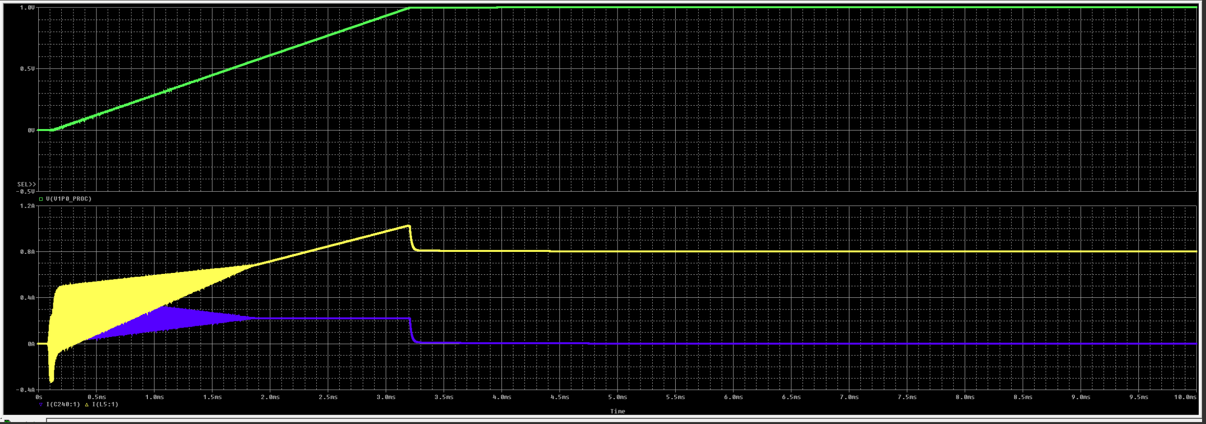

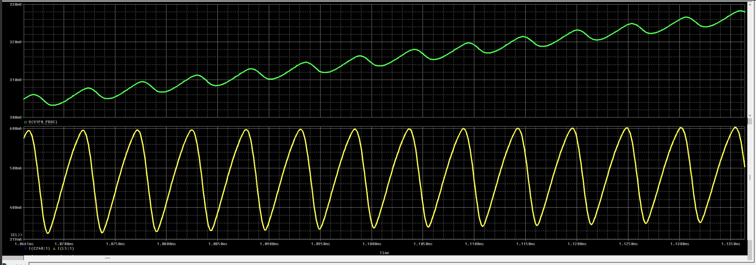

TPS50601-SP: Oscillations during startup when using TPS50601A-SP PSpice model
Part Number: TPS50601-SP
Other Parts Discussed in Thread: TPS50601A-SP
When simulating startup using the TPS50601A-SP average PSpice model, I noticed oscillations at about 184kHz. I am wondering if this is an artifact of the model, or if my circuit actually behaves this way.image.pngimage.png
