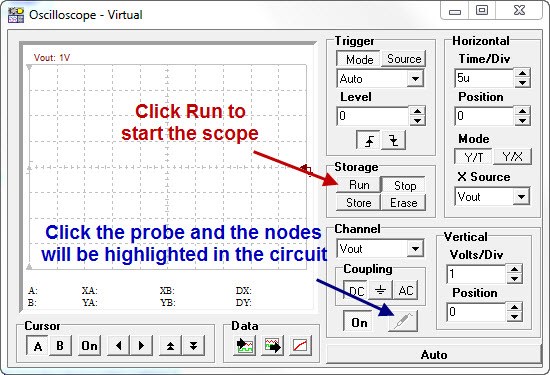

I just downloaded TINA-TI and its Getting started guide. I entered the circuit schematic and tried the oscilloscope, but I can't seem to get any trace on the scope except sometimes a flat line. Since I followed the instructions quite carefully, I can conclude that I have 3 possible problems:
1) I didn't get the circuit connections that I needed. I don't know to verify this except by dragging wires a short distance to see whether other wires move.
2) I don't know how to use the scope probe. When I touch a connection point with the arrow/finger cursor it changes to a wiring (pencil icon) and the wire drags on as I move the cursor into the scope display. (See page 9, "Place the cursor at the output of the simulated circuit,and adjust the controls in the virtual oscilloscope dialog box as needed
(step3)." This doesn't show what cursor is to be used, nor does it show the VM1 meter as selected. However the scope display does indicate VM1.
3) I have to somehow trigger a simulation to get the scope to display anything at all.
What can I do to find the problem?
Lou.

  • Lou,
    The Oscilloscope can display any signal that you wish, however, you must use the Analysis ---> Options... Save all analysis option.

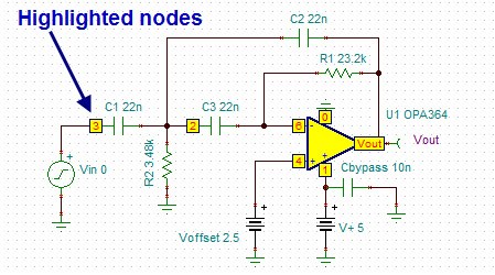

    Once this is set, you start the oscilliscope (T&M --> Oscilloscope) and click on Run. By default, the node marked with a Voltage meter will be displayed (if there is more than one meter, you can select them from the Channel drop down). If you click on the probe, the nodes in the circuit will be highlighted with yellow boxed numbers and you can click on any of thes nodes to display it.
    If you click on more than one node, they will all be displayed. You can turn them off by selecting the trace in the Channel pulldown and clicking the On toggle. If depressed, the On toggle will display the trace. If it is not depressed, the signal can be displayed by clicking on it. This allows the user to select all of the signals and switch between them during simulation without re-starting the run.
    Make sure to use a circuit that is suitable for continuous simulation. A SMPS startup curve that takes several minutes to complete would be better suited for use with the plotter, not the oscilloscope.
    Britt

  • Lou,
    When you hit Run on the Oscilloscope, it performs a transient analysis (time based). Oscilliscopes are time based where an AC analysis would be a frequency based measurement (like the Signal Analyzer) . You do not need to perform any kind of analysis before hitting the Run on the scope. Once you hit Run on the scope, the probe button should go active. Click on it and the nodes in the schematic should become active and you can then move the cursor to the circuit and click on the node of interest.
    Make sure that the circuit you are using is set up for a time based simulation (filters or average SMPS models would NOT be a good choice). If you are looking at an AC simulation, the Signal Analyzer should be used. For filters, simply click on start and it will draw the waveform on it's display. The filter examples can also be run in the scope, however, you wiill be looking at a transient output response of the filter (which is interesting, but may not be what you want...).
    Be sure to remember that the Diagram Window can be used for any of the functions you are needing. The only difference is that the diagram window is static while the T&M devices are continuous. Quite honestly, I do not use these tools other than for demonstration purposes. I do all of the waveform manipulation in the diagram window after a transient or AC run.
    Documentation is lacking and is geared toward the full version of TINA (the documentation is the same for both TINA-TI and TINA Industrial). For the T&M tools, the only documentation is under Help ---> Contents---> T&M.
    Britt
