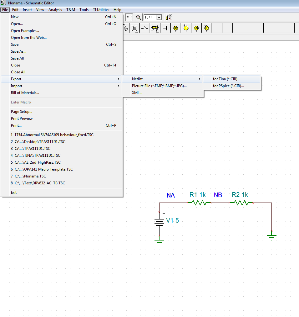

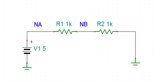

    Let’s start with option one first, say we need a voltage divider from node NA to node NB as shown below,
    To obtain the netlist for this circuit, simply aks tina to export your schematic into a .CIR file. To convert your circuit into a .CIR, just follow the following steps.
    1. First, connect your circuit in the schematic editor =) ( I know, just making sure)
         2. Go to ghe “File” pull down menu and select export for TINA as shown below

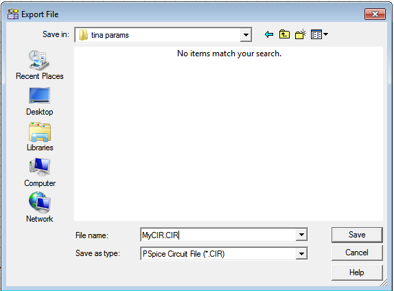

    3. Save your circuit

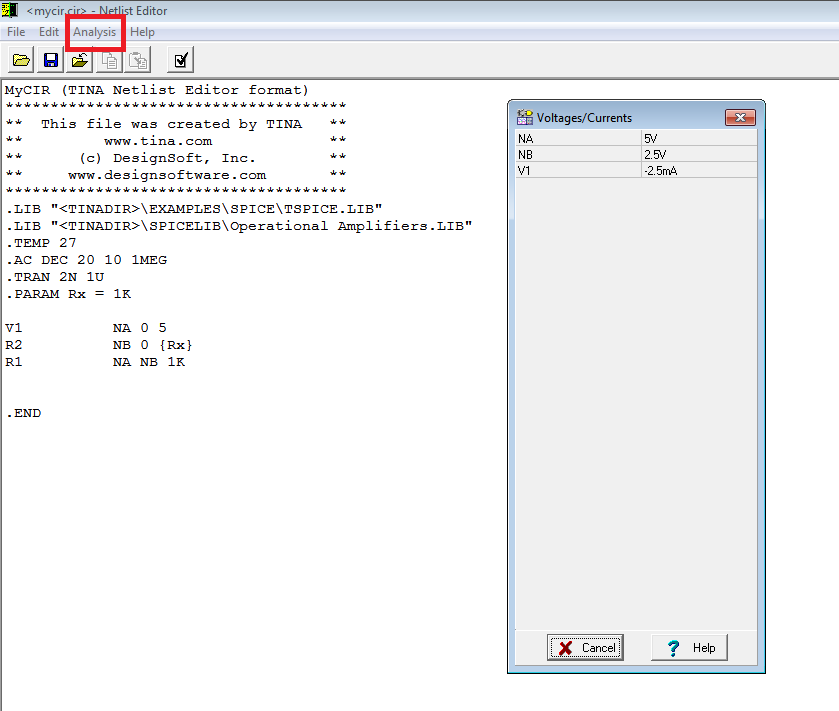

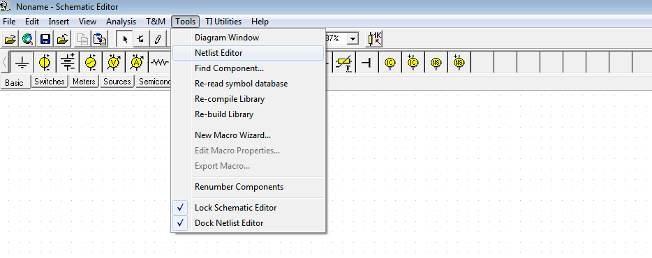

    4. Open your circuit from the netlist editor
    You should get something similar to,
    If you got to this point, you should have a very similar file apart from the .PARAM line that I added toI define my circuit parameters .You can go ahead and use as many .PARAM statements as you need. Pay attention to the curly brackets on R2, this tells the simulator to insert the value of Rx as the value for resistor R2. Now all you need to do is go to the “analysis” tab and you will be able to run all the same analysis you can run from the GUI. You should see the same dialogs for each analysis.

    Referring to our little voltage divider, the netlist representation of this circuit will look like:
