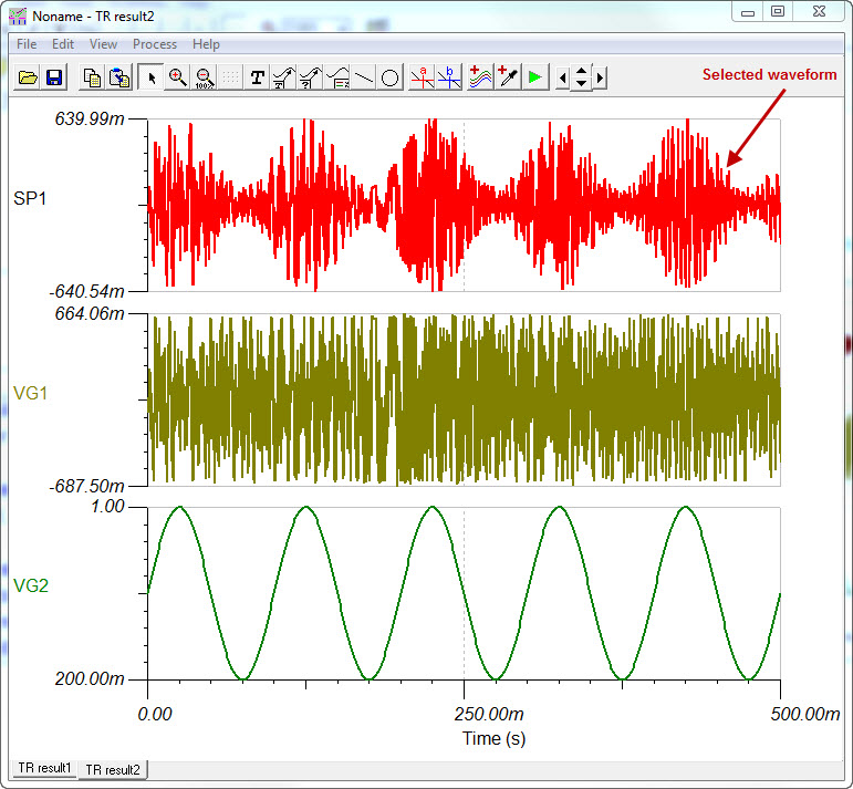

I want calculate an average value and effective value and plot them on the picture, how to edit the  formula about the average value and effective value with the post-processor tools?  thank you for your help.
  • Xiaoguang,

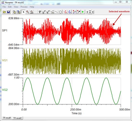

    Are you trying to plot the average value of a single waveform waveform in the post processor? I do not believe that you can plot the average value of a waveform in the plotter. However, if you are simply looking for the average value of a waveform, click on the waveform in question and it will be highlighted Red:

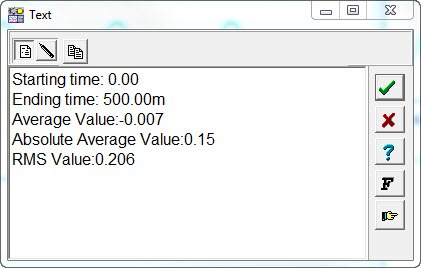

    Then click on the Process menu item and select Averages...
    The window with the average values will be displayed:
    Let me know if this is not what you were looking for.

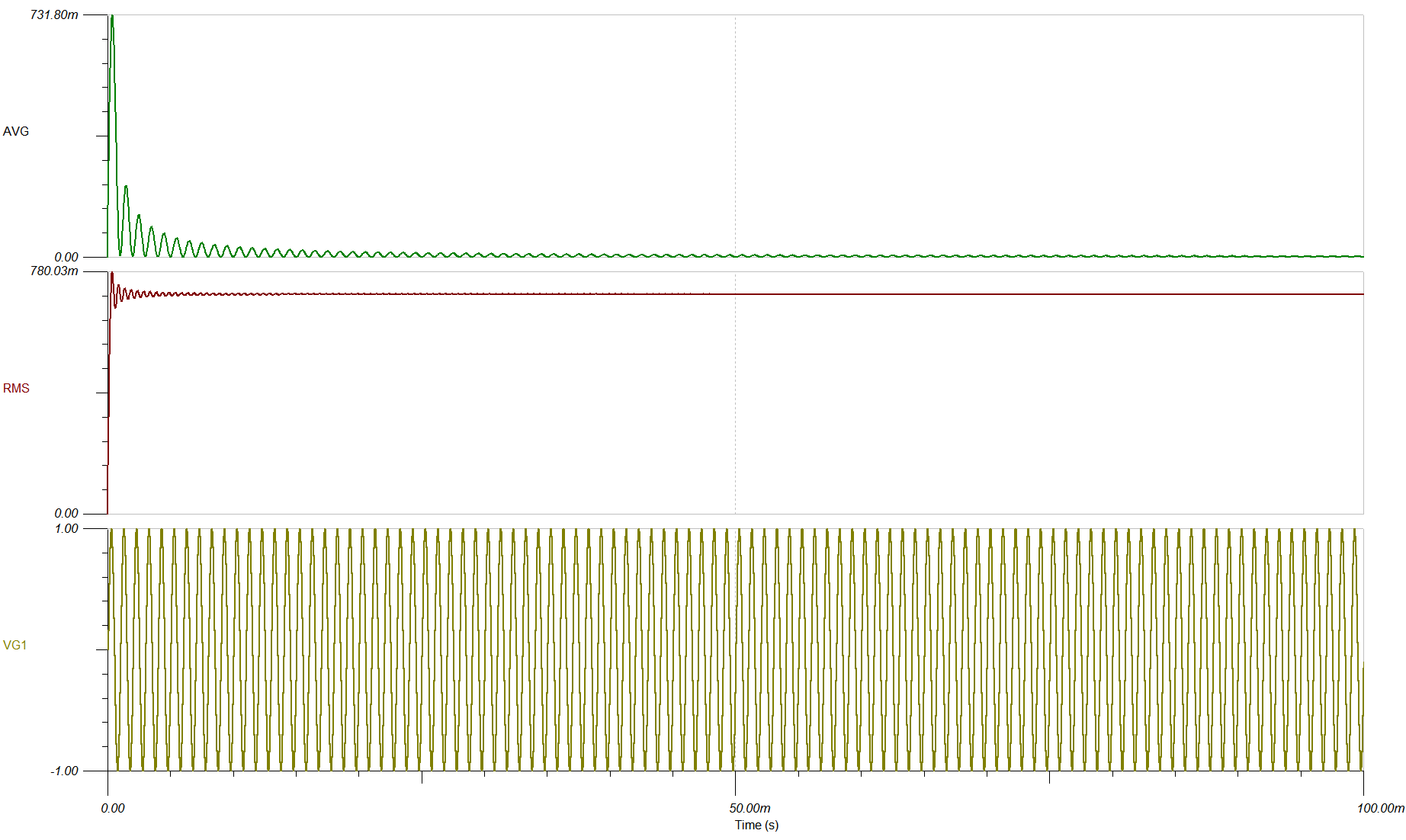

  • Xiaoguang,
            Like Britt mentioned above, I don't think there is a way to plot the AVG and RMS value using the post processing tool. However if you need to see the AVG and RMS plots you can calculate those values on the fly using voltage controlled voltage sources, e.g.
    say you need to calculate the AVG and RMS value of a voltage at a node called TEST,
    AVG = 1/T * integral( TESTdt ) in tina this will translate to 1/(TIME + correction factor) * SDT(V(TEST))
    * the correction factor avoids the 1/0 division when TIME = 0 i.e. simulation starts.
    Similarly
    RMS =  SQRT(1/(TIME + correction factor) * SDT(POW(V(TEST),2)))
    I have attached an schematic containing both sources. The simulation results are given below,
    Marcos
