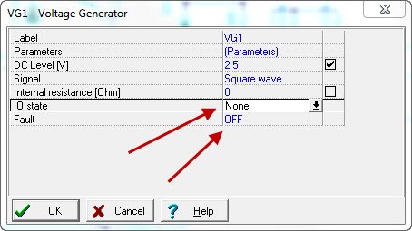

Hello Everyone, please find the attached simulation model of charge pump relay drive circuit, i have tried to simulate this circuit on TINA but nothing happen, i guess there is something wrong in the parameter selection or something else, i dont know, what i am missing specifically.

    I get a ERC error for the RL1 SPNC-Defauly relay at the far right of the schematic. What is it's purpose? Is there a load after the relay that is missing? Also, the VG1 input has a DC level of 2.5V and then an 800Hz square wave of 2.5V. Is that the correct input? Make sure to have the IO state as Input and the Fault set to None on VG1.
    Are you running a transient simulation? When I run a transient simulation, it is set for 1us which won't show you much on an 800Hz waveform. You have not placed any voltage/current monitors either. Have you tried looking at any nodes in particular? What kind of output are you expecting?

    I am doing simulation by Analysis-DC Analysis-calculate nodal voltage

    Did you make the changes I highlighted in the original post to VG1? If you did, you would notice that the curcuit does provide the DC information. Also, be sure to close the switch SPST1.
    From your circuit:
    Please change the fields to Input and None respectively and VG1 will work correctly. Not sure why these were changed from the default values.
    If you are only interested in the voltage provided to the relay, why is the relay necessary? You will continue to get the ERC warnings unless you remove the relay or add a load to it. Also, be sure that the Switch at the input is closed.
