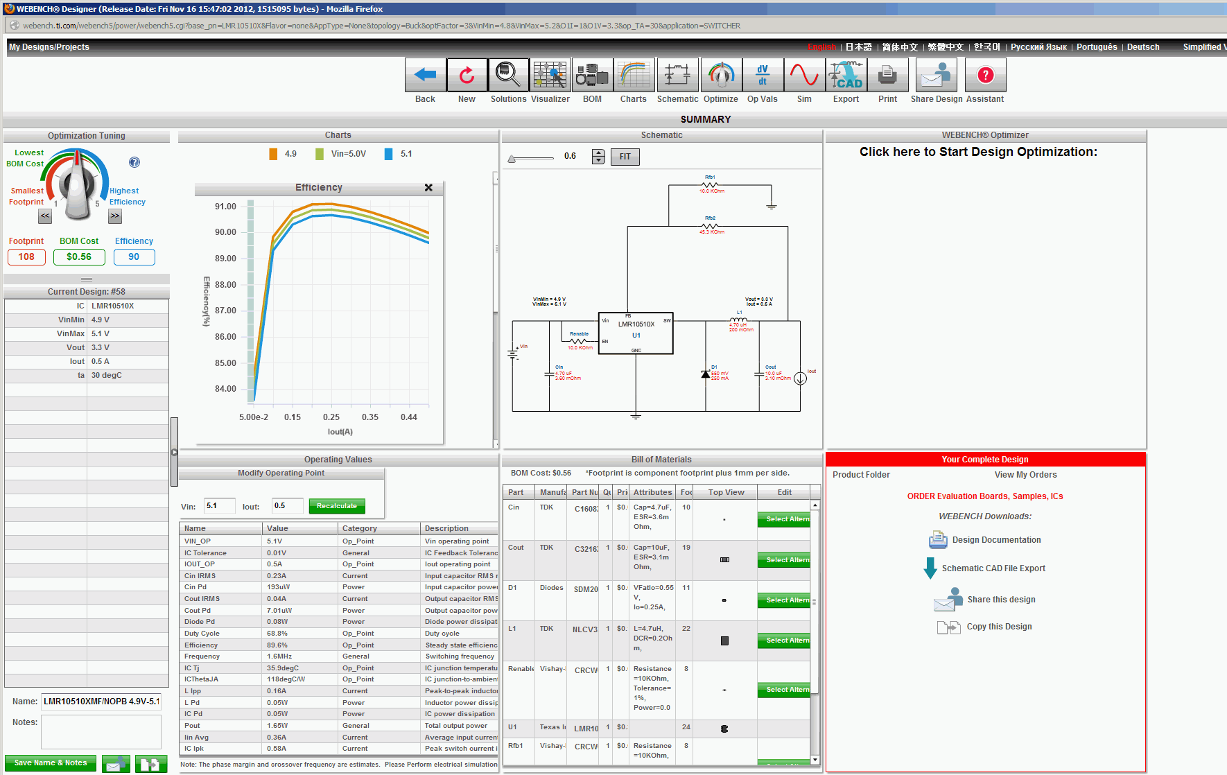

  • Here are the parameters entered into the ti.com Webbench:
    Vinmin=4.9V
    Vinmax=5.1V
    Vout=3.3V
    Iout=0.5A
    ta=30degC
    Optimization=3 (default)
    All other parameters left to defaults.
    I have chosen the uppermost 1.6MHz LMR10510X design.
    Footprint=108mm^2
    BOM Cost: $0.56 (obviously a lie)
    Efficiency=90%
    The recommended Inductor is a TDK NLCV32T-4R7M-PFR
    The link on top of that page is:
    http://webench.ti.com/webench5/power/webench5.cgi?base_pn=LMR10510X&Flavor=none&AppType=None&topology=Buck&optFactor=3&VinMin=4.8&VinMax=5.2&O1I=1&O1V=3.3&op_TA=30&application=SWITCHER
    (which doesn't fit to my entered values as I have changed it in Webench after the first run)
    Screenshot attached (despite bad layout).
    I would bet that the circuit even works, as this inductor is a medium quality Q=15(typ.) type.
    Anyway, the NLCV32T series is really cheap, but it melts away quickly if the reflow is done just a tiny bit too hot...
    Clemens Koller
    Embeon SDE
    Screenshot:
  • Mr. Koller,
    Looking at all the alternate inductors suggested by WEBENCH, the NLCV32T-4R7M-PFR was selected for the design because it was cheaper and smaller than some of the other options.
    If you would like to select a different inductor for your design, you can use the "Select Alternate Part" option in the Bill of Materials window and select a different inductor there.
    Also, the pricing that we list in WEBENCH is fairly accurate, since the component pricing comes from a live feed provided by many of the distributors.
    Let me know if you have any other questions or concerns.
