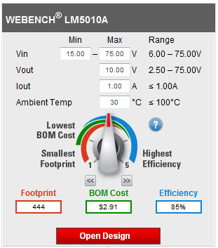

    The LM5010A is available in WEBENCH® Power Designer. You can access it directly from the product folder. Simply enter your VIN, Vout, and Iout and hit the Open Design button:
    There is also a quick start calculator (an Excel spreadsheet) for the LM5010A under the Tools section.
    Currently, we do not have a macromodel available for the device.

  • We now have WEBENCH Altium Connector and WEBENCH Simulation Export into Altium.
    Here's some information about WEBENCH Altium Connector: http://blog.live.altium.com/Blogs/ti-webench-release
    You need to be on AD14 and above.
    First please install the WEBENCH Altium Connector App from inside Altium Extensions and activate it.
    Then please go to LM5010A product Folder:
    http://www.ti.com/product/lm5010a
    and select "Open Design" from inside the WEBENCH(R) LM5010A panel.  This will open WEBENCH design using this part.  You can also select "Simulate Now" to run electrical simulations online using WEBENCH.  To download the simulation schematic into Altium, select "CAD Export" from the WEBENCH Menu Bar and select "Altium Designer" inside the form.  This will download the design SimXML file specific for Altium.
    You can open this file using the WEBENCH Menu (select Open WEBENCH Design) inside Altium.  This will import the WEBENCH SimXML file which contains the simulation schematic, SPICE models, and simulator settings.  You you be using the WEBENCH Simulation Engine which gets installed as part of the WEBENCH Altium Connector App.
