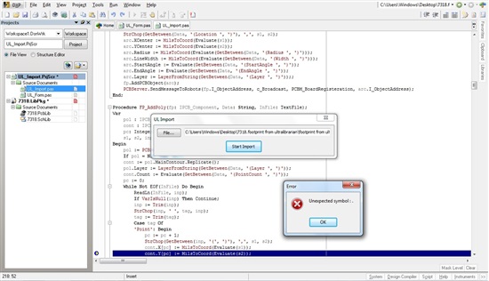

Hi! I downloaded the .bxl file with Ultra Librarian to generate the schematic and footprint of the TUSB9261 for Altium Designer.
The script run on Altium always stucks with this error:
"Unexpected symbol : ."
Can you help me? Thank you.

Kaiyu,
One of our Altium users within TI did not have a problem exporting the TUSB9261 bxl to Altium. Are you using a language pack with your Windows installation? Using a language pack (with some languages) will cause the exported files to fail due to replacement of comma's and periods. If language pack is not the problem, what version of UltraLibrarian and Altium are you using?

Hi Janet! Thank you for the reply!
I'm not using any language pack, infact the script run successfully for other TI IC's .bxl
I'm using Altium Designer 10 and the latest release of Ultra Librarian.
Can you please attach the exported library of TUSB9261?
I need it urgently.Thank you!

Hello Kaiju,
The updated version of UltraLibrarian Free Reader software ( version 5.3.409) is now available at http://webencht.ti.com/cad.
Janet
Hello all,
I find that the newer version of Ultra Librarian can work around this error,
please see my post here:
